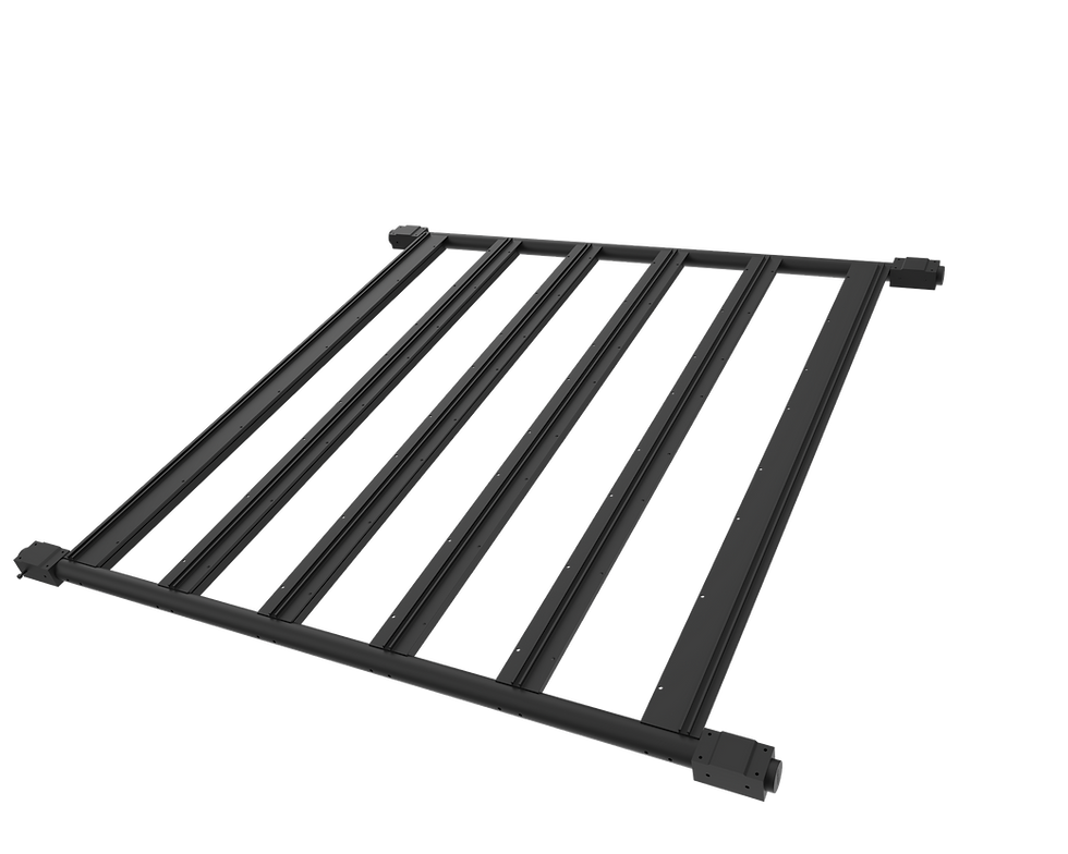

How much cutting area do I lose with the QCW installed?
You do not technically lose any of the machine's total advertised cutting area with the QCW, but you do lose access to about 1.5 to 2 inches of the wasteboard material at the very back because the spindle physically cannot reach it.
The spindle can often travel slightly beyond the front of the wasteboard slats, requiring you to carefully position your material to ensure it is fully supported within the active cutting zone.
How stable is the QCW frame during operation?
The QCW frame is highly stable and rigid, though some vibration or "shake" can occur during high-speed 3D carves if it is used with the optional fixed stand legs rather than a solid, heavy workbench.
To maximize stability, we ecommend ensuring the leveling feet are properly adjusted to eliminate any twist and, if necessary, adding cross-bracing to the support structure to counter lateral forces during heavy cuts.
Is the QCW more convenient than building a custom table or work surface?
The QCW is generally considered more convenient for beginners because it provides a plug-and-play solution that ensures the machine is self-squaring and properly aligned without requiring advanced woodworking skills.
While building a custom torsion box table can be cheaper and offer more storage, the QCW allows you to start carving almost immediately and simplifies the process of replacing individual wasteboard slats in the future.
Can attaching the QCW to a table negate its benefits?
Attaching the QCW directly to a table can negate the benefits of the Any Surface Leveling System, as bolting the frame down prevents the adjustable feet from compensating for any twist or unevenness in the table or floor.
To maintain the frame's ability to ensure the machine remains perfectly coplanar, many users prefer to let the heavy frame sit freely on the surface or use brackets that trap the feet without strictly bolting them down.
Does the QCW affect usable cutting area or available space for tools?
The QCW frame is designed to maximize the cutting area, but it shifts the work zone forward, which can leave a portion of the rear wasteboard inaccessible to the spindle.
This forward shift means that at the ""home"" position, the bit and dust boot may actually overhang the front of the frame, a factor that must be considered when building enclosures or planning space for front-mounted tools.
