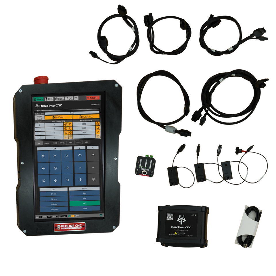

What’s Included:
  • REDLINE Control System
    • REDLINE 15" HMI Touch Display
    • RealTime CNC Motion Controller
    • REDLINE Mini Input/Output Adapter (Adds ATC Port and Two(2) I/O Ports)
  • Redline Homing Sensors
  • Wires from the Realtime Motion to connections on ends of rails

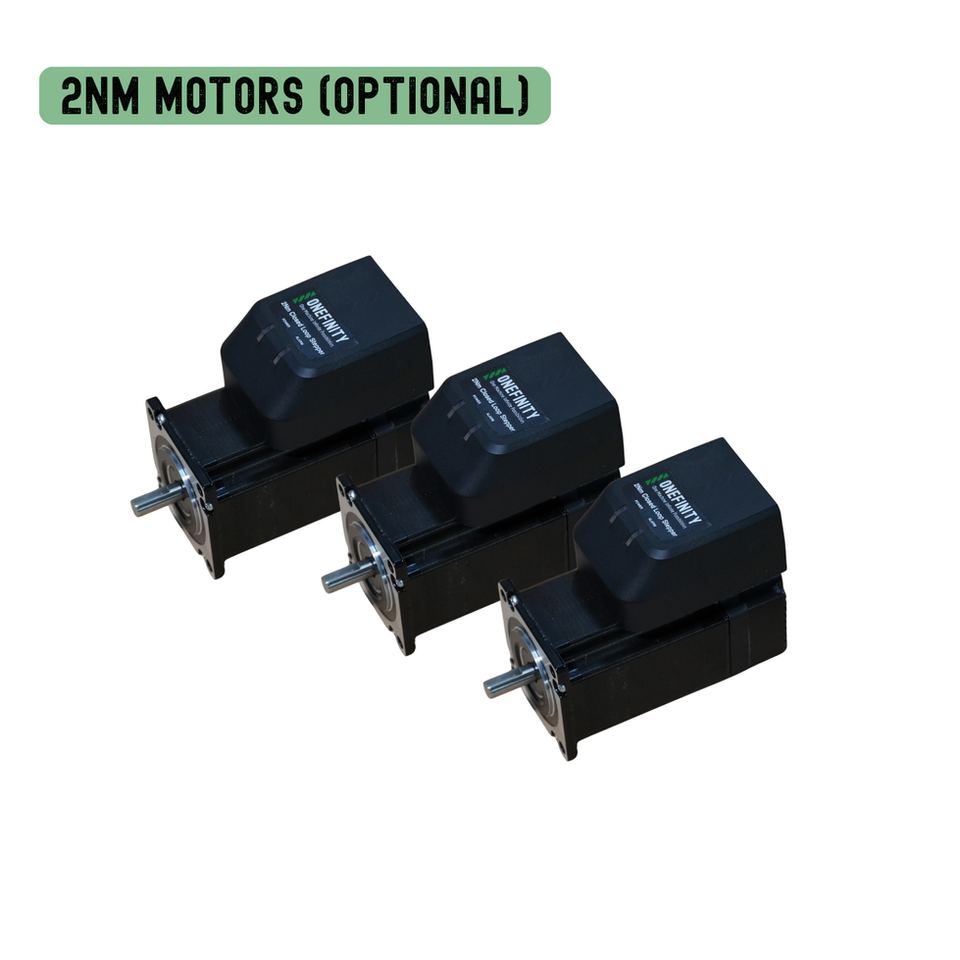

  • Optional (Upgraded 2nm Closed Loop motors - (Three (3) standard motors (X,Y,B))

**Please note: Do not return your 1.2 Nm Closed loop motors UNLESS you have purchased the optional 2Nm motor upgrade.  These will be reused on your Elite machine.
