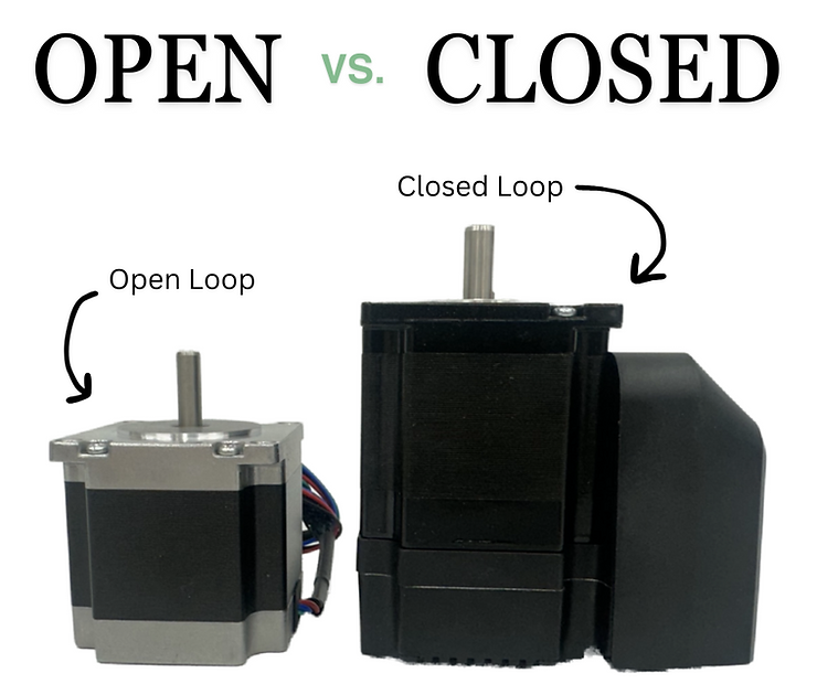

One of the features of Onefinity CNC Elite machines is it's advanced close loop stepper motors over the open look stepper motors of the X35 and X50 Onefinity machines. Most hobby CNC routers use open loop steppers. Many new users to CNC machines often wonder the differences between the two. Let's look at the differences.
Open vs. Closed Loop Stepper motors
Closed-loop and open-loop stepper motors are both commonly used in hobby CNC routers, and they have some key differences in terms of performance and cost. Here's a brief overview of each:
Open-Loop Stepper Motors:
  1. Cost: Open-loop stepper motors are generally more affordable than closed-loop systems, which makes them popular in hobbyist applications.
  2. Simplicity: They are straightforward to set up and use, as they don't require additional feedback systems or encoders.
  3. Control: Open-loop systems rely on sending step pulses to the motor to move a precise distance. However, they can lose steps, resulting in missed positions and potential inaccuracies.
  4. Lack of Feedback: Open-loop systems lack feedback mechanisms to detect errors or missed steps. This means they can't automatically correct for errors, making them less suitable for applications requiring high precision and accuracy.
  5. Limited Performance: In demanding situations, open-loop stepper motors may struggle to maintain accuracy, especially at high speeds or with rapid changes in direction.
Closed-Loop Stepper Motors:
  1. Cost: Closed-loop systems are generally more expensive than open-loop systems due to the additional hardware required.
  2. Feedback: Closed-loop stepper motors incorporate encoders to provide real-time feedback about the motor's position. This feedback allows the system to detect and correct errors, reducing the chances of missed steps.
  3. Accuracy and Precision: Closed-loop systems are more accurate and precise than open-loop systems. They can maintain accurate positioning even in the presence of external forces or resistance.
  4. Performance: Closed-loop systems are more reliable and capable of handling higher speeds and rapid changes in direction, making them suitable for more demanding CNC applications.
  5. Error Detection and Correction: If a closed-loop system detects a missed step or error, it can adjust the motor's position to correct it, ensuring accurate and consistent results.
In the context of hobby CNC routers, the choice between closed-loop and open-loop stepper motors depends on your specific needs and budget. Open-loop stepper motors are a cost-effective choice for less demanding applications where precision and accuracy are not critical. Closed-loop systems are better suited for tasks that require high accuracy and the ability to handle external disturbances.
Ultimately, the choice should be based on the level of precision and performance you require for your CNC router, as well as your budget constraints.
