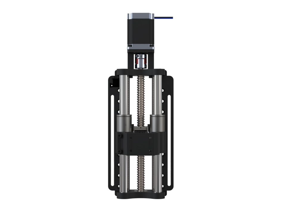

Take your Onefinity to the next level with the powerful, rigid and speedy Z-20 Heavy Duty Z-Slider. This simple to install upgrade offers more speed and torque than the existing Z-Slider with increased travel.
Z-20 features:
Larger, more powerful stepper motor.
Large 20mm solid, linear rail shafts.
Sealed, high-load, linear bearings.
1610 ball screw for increased speeds.
160mm of total travel distance.
4 mounting positions.
65mm and 80mm spindle mount options.
Provisions for mounting a Laser and other accessories
Built in Suckit Dust Boot Mounts
Thick, precision machined back plates
Quick and simple installation
Please note: Due to the thick back plates, your router location will shift forward.
Warning: If used in conjunction with an 65 or 80mm spindle, your spindle may drop due to gravity.  Please be aware of this when powering off the machine.
